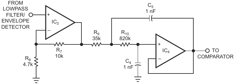

A second-order lowpass filter …
A second-order lowpass filter removes ripple from the envelope detector's output

Figure 3. A second-order lowpass filter removes ripple from the envelope detector's output
