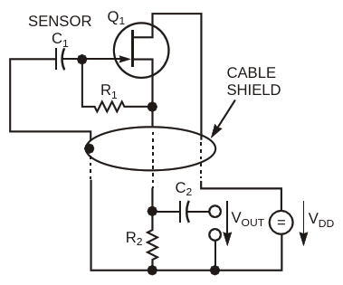

The JFET in this circuit effectively multiplies the value of R

Solve low-frequency-cutoff problems in capacitive sensors
Figure 1. The JFET in this circuit effectively multiplies the value of R
