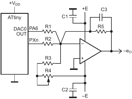

Circuit used to improve …
Circuit used to improve the resolution of a peripheral DAC while also reducing the output resistance and offset of the DAC
Peter Demchenko
Extending the resolution of a peripheral DAC
Figure 1
