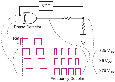

An XOR gate, voltage-controlled oscillator, and a few passive components make a frequency doubler

Figure 2. An XOR gate, voltage-controlled oscillator, and a few passive components make a frequency doubler
