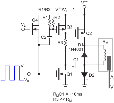

Relay and solenoid driver circuit doubles supply voltage to conserve sustaining power
Figure 3
10 Kb
Figure 1. Basic driver circuit where C1 actuates, current-halving R1 sustains, then C1 discharges through R1 during T
OFF
Figure 2. Q1 and Q2 cooperate with C to double V
L
for actuation, Q2 and D2 sustain, then Q3 rapidly discharges C through R to quickly recover for the next cycle
Figure 3. Level shifting Q4, R1, and R2 are added to accommodate V
> V
L
