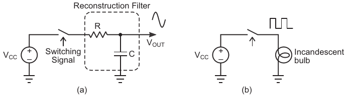

The PWM DAC in …
The PWM DAC in (a) uses a reconstruction filter to remove signal harmonics from the PWM. The circuit in (b) feeds the unfiltered PWM signal to the incandescent bulb, resulting in no wasted power
Barry L. Dorr
Using unfiltered PWM to drive high-power resistive loads
