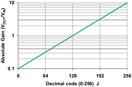

The absolute gain [G
ABS
ABS
= 10(J/128 -1)] versus decimal code (J)

Figure 4. The absolute gain [G
ABS
