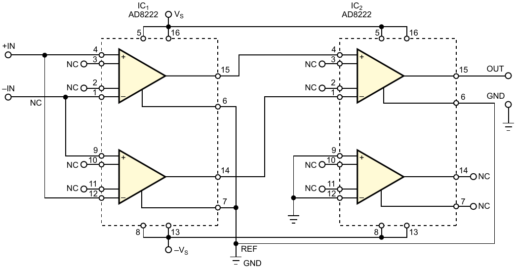

Based on two dual-section …
Based on two dual-section instrumentation amplifiers, this composite instrumentation amplifier offers a gain of two with an error margin of less than 0.06% and requires no gain-setting resistors
Marián Štofka
Gain-of-two instrumentation amplifier uses no external resistors
Figure 1
