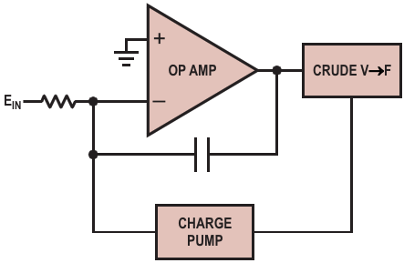

Precision charge pump closes feedback loop to make "crude V→F" accurate from "Designs for High Performance Voltage-to-Frequency Converters"

Figure 1. Precision charge pump closes feedback loop to make "crude V→F" accurate from "Designs for High Performance Voltage-to-Frequency Converters"
Figure 2. The realities of a diode pump where errors can arise such as non-linear and temperature-dependent voltage drop, shunt capacitance, reverse recovery charge, and more
Figure 3. TBH adds a half-amplitude reverse-polarity pump that subtracts error terms
