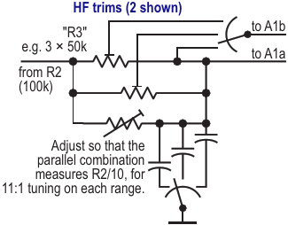

Figure 5. For multi-range use, timing capacitor C1 is switched. To trim the HF response for each range, R3 must also vary
