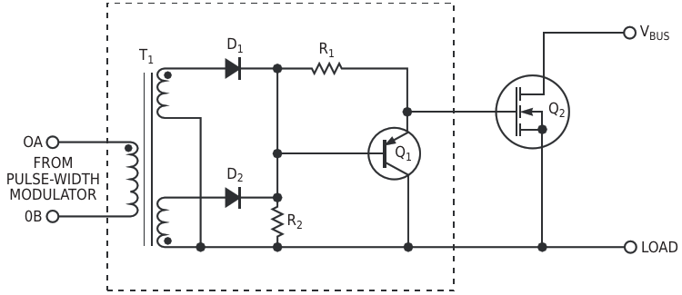

You can use this low-cost circuit to drive high-side FETs or IGBTs
Carlisle Dolland
High-side driver feeds IGBTs and MOSFETs
Figure 1
10 Kb
Figure 1. You can use this low-cost circuit to drive high-side FETs or IGBTs
Figure 2. Two FETs in parallel provide more power than the circuit in Figure 1
