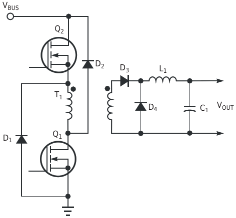

A two-switch topology reduces the transistors' voltage stress to the bus voltage

Two-switch topology benefits forward and flyback power converters
Figure 1. The traditional forward converter puts a comparatively large voltage stress on the switching transistor
Figure 2. A two-switch topology reduces the transistors' voltage stress to the bus voltage
