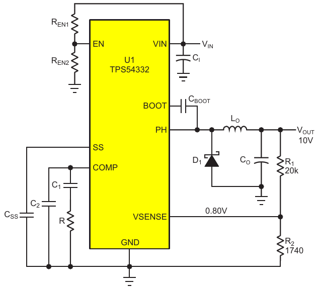

The (almost) universal regulator …
The (almost) universal regulator output programming network where V
OUT
= V
SENSE
(R
1
/R
2
+ 1) = = 0.8 V × (11.5 + 1) = 10 V
Stephen Woodward
Add one resistor to allow DAC control of switching regulator output
Figure 1
12 Kb
Figure 1. The (almost) universal regulator output programming network where V
OUT
= V
SENSE
(R
1
/R
2
Figure 2. Regulator output programming with a DAC and the KISS network where V
OUT
= (V
C
) × (R
1
/R
2
) = = (2.5 to 0 V) × 4 = 0 to 10 V
