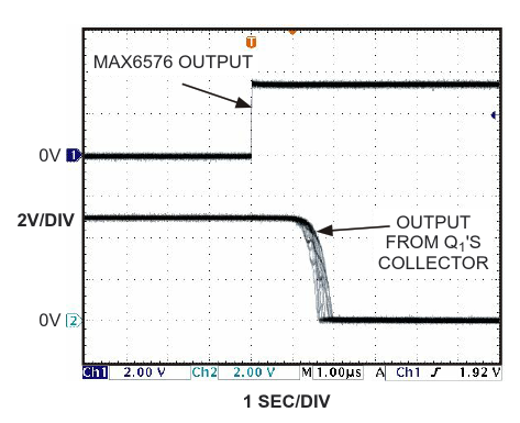

Measured from the positive-going …
Measured from the positive-going edge of IC2's output to the circuit's output at Q1's collector, the relative jitter averages less than 1 µsec

Figure 2. Measured from the positive-going edge of IC2's output to the circuit's output at Q1's collector, the relative jitter averages less than 1 µsec
Figure 3. As in Figure 2, Q1's average output jitter with respect to IC1's negative-going output also averages less than 1 µsec
