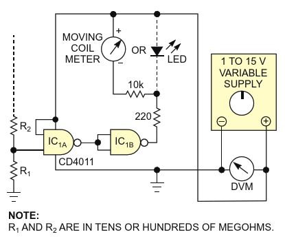

Use CMOS gates and a variable power supply to find an unknown voltage

Logic gates form high-impedance voltmeter
Figure 1. Use CMOS gates and a variable power supply to find an unknown voltage
Figure 2. The gate's threshold voltage is nearly linear with respect to the power-supply voltage
