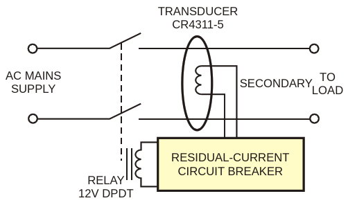

The residual-current circuit breaker uses a transducer to monitor the supply current and a relay to disconnect the mains from the load

is a precision, fast-acting comparator and controls whether the relay is active based on a preset reference-voltage level
Figure 2. The residual-current circuit breaker uses a transducer to monitor the supply current and a relay to disconnect the mains from the load
