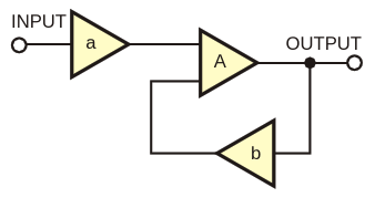

Control-system feedback theory explains …
Control-system feedback theory explains the operation of the circuit in Figure 1

Figure 1. By using two optocouplers instead of one, you can cancel temperature-dependent gain drift
Figure 2. Control-system feedback theory explains the operation of the circuit in Figure 1
