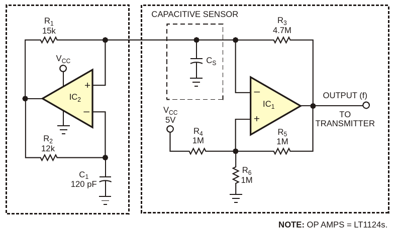

The modulator portion provides …
The modulator portion provides improved performance over the circuit in Reference 1; the negatron increases sensitivity and resolution

Improved frequency modulator uses «negatron»
Figure 1
29 Kb
Figure 1. The modulator portion provides improved performance over the circuit in Reference 1; the negatron increases sensitivity and resolution
