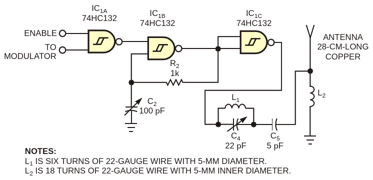

This simple transmitter from Reference 1 allows you to remotely measure physical phenomena

Figure 2. This simple transmitter from Reference 1 allows you to remotely measure physical phenomena
