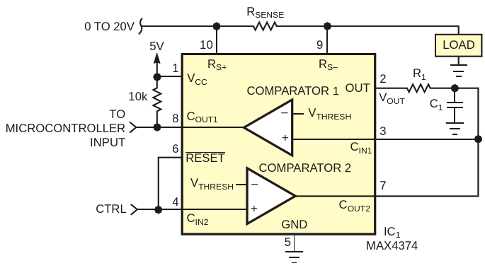

The duration of a …
The duration of a negative-going pulse at C
OUT1
is proportional to the current flowing through R
SENSE

High-side current sensor has period output
Figure 1. The duration of a negative-going pulse at C
OUT1
SENSE
