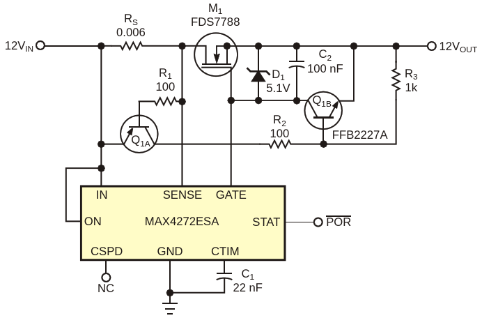

Minimize the short-circuit current pulse in a hot-swap controller
Figure 1. A typical hot-swap controller circuit exhibits a 30-µsec short-circuit current pulse of 400 A peak
Figure 3. The addition of Q
1
increases the gate-pulldown current, limiting the short-circuit-current duration to less than 0.5 µsec
Figure 5. This hot-swap controller has fast limiting of short-circuit current peaks
