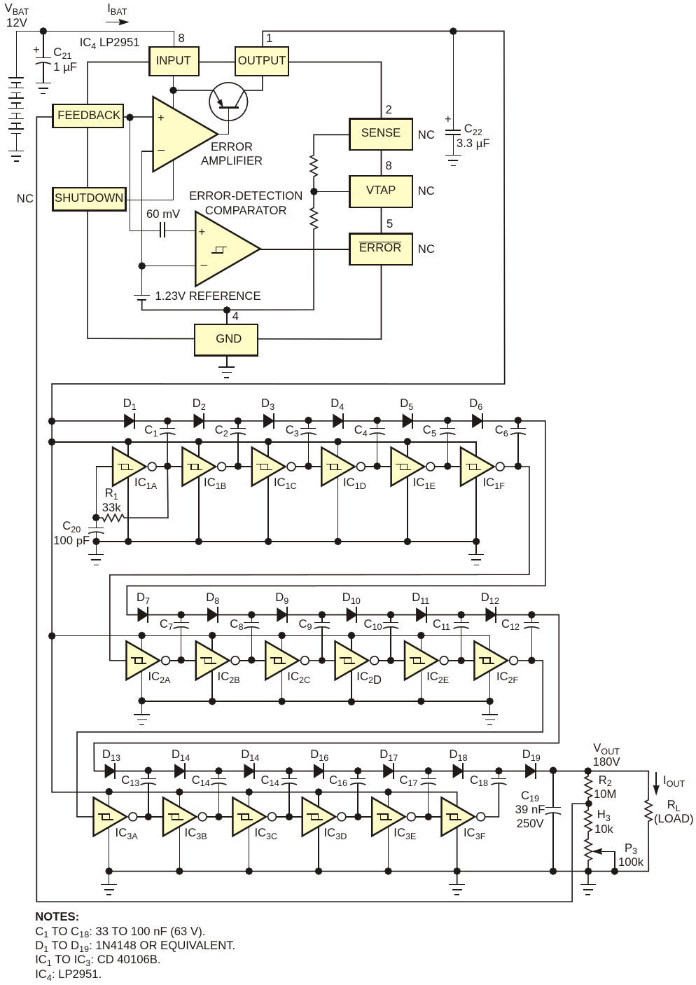

This four-IC circuit uses …
This four-IC circuit uses no transformers and converts 12 V to 180 V, using off-the-shelf components

Build a transformerless 12V-to-180V dc/dc converter
Figure 1
29 Kb
Figure 1. This four-IC circuit uses no transformers and converts 12 V to 180 V, using off-the-shelf components
Figure 2. This circuit illustrates the operating principle of the basic voltage-doubler cell
