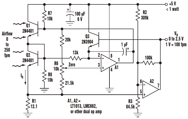

The circuit combines ideas from two earlier IFDs to implement a simple, linearized thermal anemometer. An ambient-temperature-compensated device, it is robust and power-efficient
