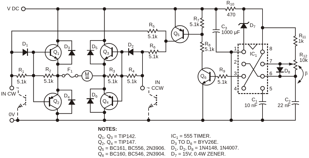

You can set a motor's rotational direction and speed using this simple circuit
Jean-Bernard Guiot
Circuit Provides Bidirectional, Variable-Speed Motor Control
Figure 1
48 Kb
Figure 1. You can set a motor's rotational direction and speed using this simple circuit
Figure 2. The position of the wiper on the speed-control potentiometer determines the duty cycle of the chopper circuit. When it is fully down, β = 0 (a); when it is fully up, β = 1 (b)
