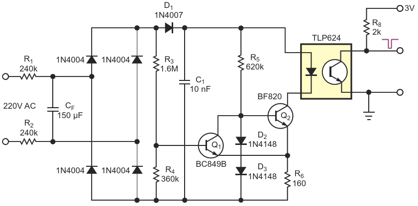

This circuit overcomes problems …
This circuit overcomes problems of excessive power consumption, uncertain switching, and LED aging

Improved Optocoupler Circuits Reduce Current Draw, Resist LED Aging
Figure 1. Establishing galvanic isolation with the help of optocouplers between circuits that operate at different ground potentials looks deceptively simple. Optocouplers draw power from the isolated circuit, and switching can be relatively slow and uncertain beca
Figure 2. This circuit overcomes problems of excessive power consumption, uncertain switching, and LED aging
