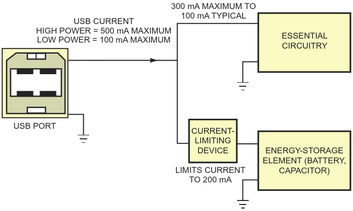

In this typical method …
In this typical method for drawing power from a USB port, the storage-element current is limited to a fixed value that is less than optimal

Figure 1. In this typical method for drawing power from a USB port, the storage-element current is limited to a fixed value that is less than optimal
