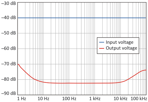

With the transistors shown in Figure 1, the power-supply rejection holds well beyond the audio band

Figure 2. With the transistors shown in Figure 1, the power-supply rejection holds well beyond the audio band
