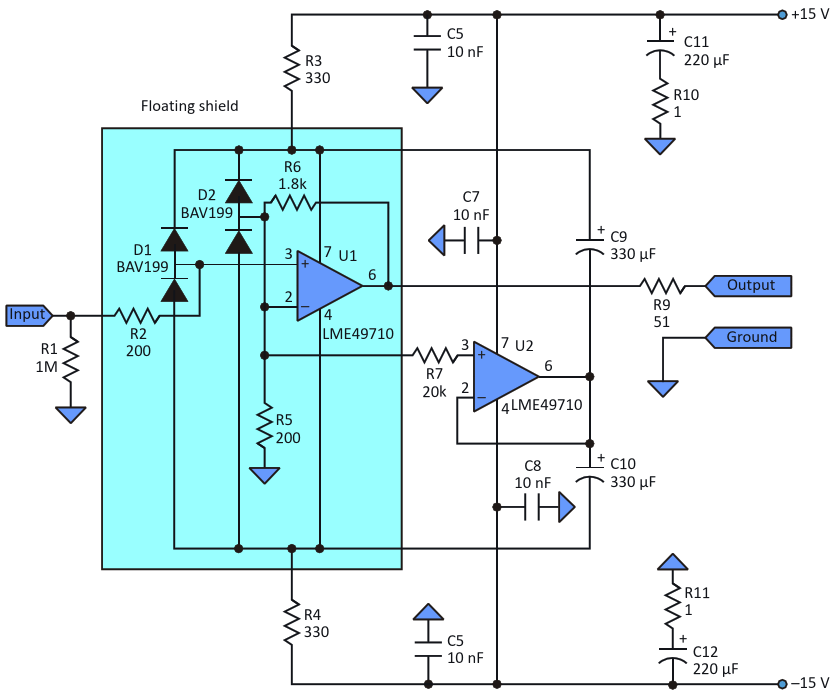

With some changes in components, the supply bootstrapping principle can also be used with an amplifier with gain (U2)

Figure 1. These curves for an LME49710-based standalone unity follower show distortion when fed by a 5-V rms signal source with a 1-MΩ source impedance (a), as well as for the circuit of Fig. 2 fed from the same source (b) and the source generator residual (c). Eac
Figure 2. Using a circuit that includes a composite unity buffer with supply bootstrapping improves the distortion performance of the device significantly
Figure 3. With some changes in components, the supply bootstrapping principle can also be used with an amplifier with gain (U2)
