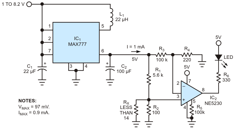

This short-circuit detector uses …
This short-circuit detector uses little power, and provides low currents and voltages to avoid damage to the device under test
W Dijkstra
Flea Power Circuit Detects Short Circuits
