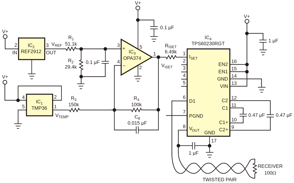

In this circuit, the …
In this circuit, the LED driver drives the 4- to 20-mA current loop proportionate to a sensed temperature of -10 °C at 4 mA and 50 °C at 20 mA
Scot Lester
Battery-Operated Remote-Temperature Sensor Drives 4- to 20-mA Current Loop
Figure 1
