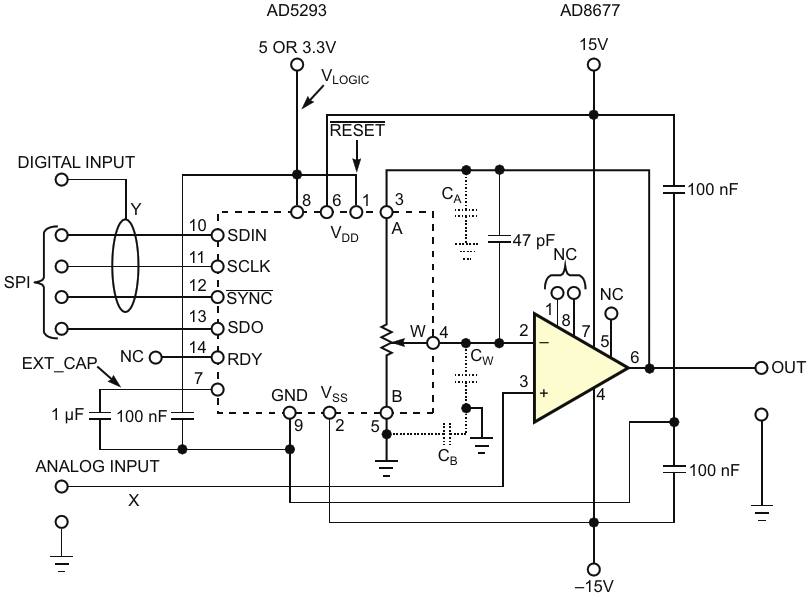

The resistive DAC-potentiometer forming …
The resistive DAC-potentiometer forming the feedback for an op amp controls the op amp's gain as inversely proportional to the digital-input-data word. The circuit thus becomes a two-quadrant divider
Marián Štofka
Resistive DAC and op amp form hybrid divider
