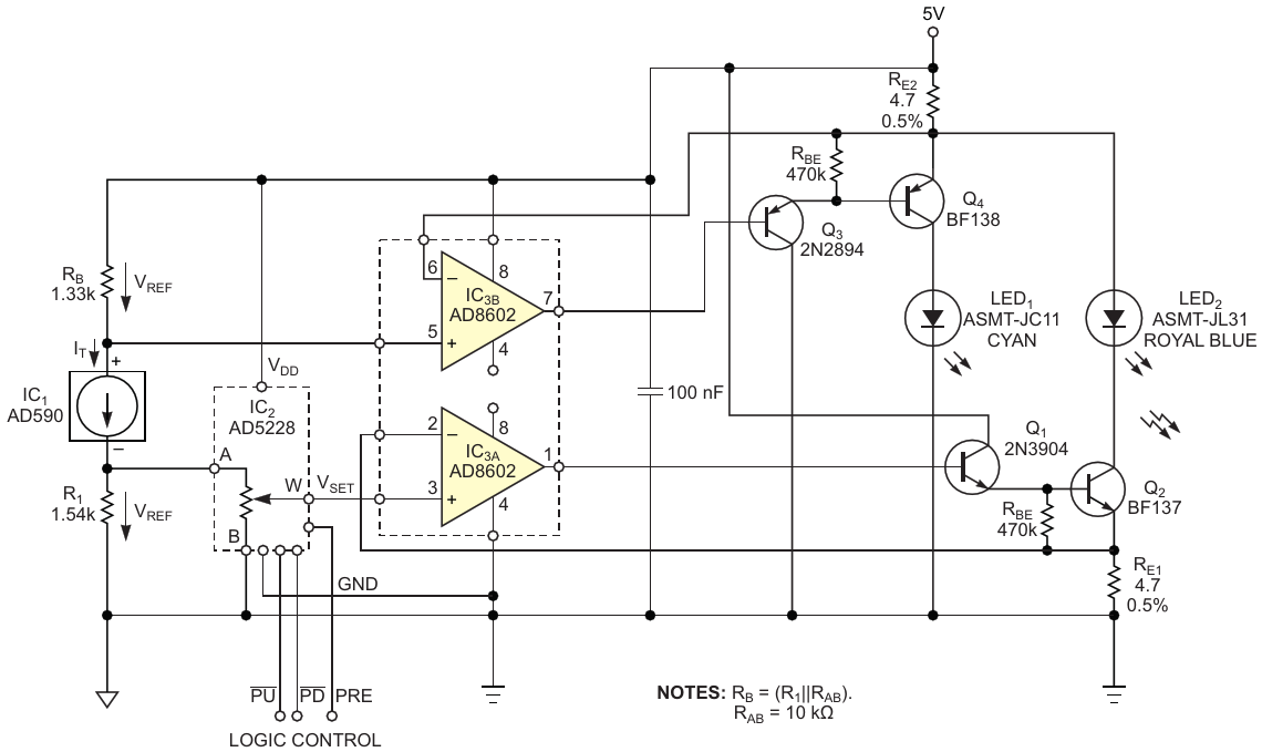

A current source and …
A current source and a current sink drive two LEDs. The balance of current sets the hue
Marián Štofka
Finely tune the hue of blue-light sources
