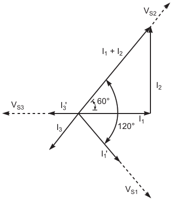

Phase-sequence indicator uses few passive components
Figure 4
8 Kb
Figure 1. This conceptual circuit can detect both phase sequences
Figure 2. When the voltages across R
1
and C
2
are equal, V
C1
= -V
R2
, V
C1
+ V
R1
= V
S1
, and V
C2
+ V
R2
= V
S2
Figure 3. This phase-indicator circuit balances branch voltages and currents and requires no ground reference. These component values are for a 60-Hz line frequency
Figure 4. I
3
has half the magnitude and an exactly opposite direction to (I
1
+ I
2
) in Figure 3
