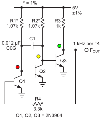

It's a far better (temperature sensing) oscillator than an amplifier
Stephen Woodward
1 kHz per degree Kelvin temperature sensor
Figure 1
11 Kb
Figure 1. It's a far better (temperature sensing) oscillator than an amplifier
Figure 2. C1 provides oscillation-provoking positive feedback by bypassing Q2, as revealed by Q1 and Q2 collector waveforms
Figure 3. Figure 1's output frequency versus absolute temperature (T
ABS
). F
OUT
= 1 kHz (T
ABS
±2 °K)
