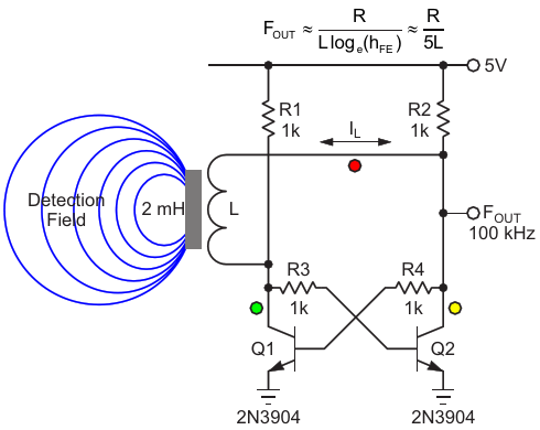

Cross-couple flip-flop outputs with …
Cross-couple flip-flop outputs with a choke to make an oscillator with period proportional to inductance and thus a simple sensor of metallic objects
Stephen Woodward
Flip-flop plus choke comprise simple and cheap inductive sensor
Figure 1
15 Kb
Figure 1. Cross-couple flip-flop outputs with a choke to make an oscillator with period proportional to inductance and thus a simple sensor of metallic objects
