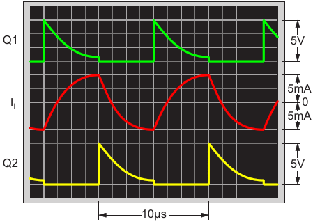

Oscillator waveforms: I
L
and …
L
and Q1, Q2 output signals

Figure 3. Oscillator waveforms: I
L
