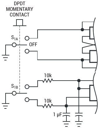

You can restructure the switch-interface circuit of Figure 1 as shown

Figure 1. This is the original circuit, as published in Reference 1
Figure 2. You can restructure the switch-interface circuit of Figure 1 as shown
Figure 3. You can simplify the oscillator-enable structure, as shown
Figure 4. This circuit uses fewer and cheaper components than the circuit in Figure 1
