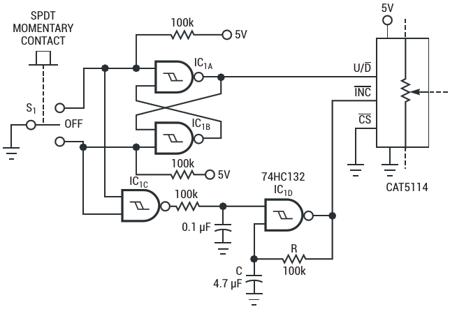

Single switch controls digital potentiometer
Figure 1. This is the original circuit, as published in Reference 1
