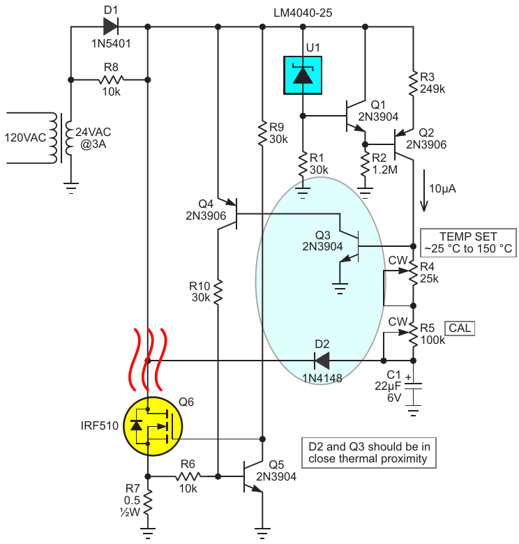

Self-sensing MOSFET thermostat using …
Self-sensing MOSFET thermostat using precision current source for temperature setpoint reference
Stephen Woodward
Low-cost precision adjustable current reference and application
Figure 3
18 Kb
Figure 1. Adjustable current sink with good precision and other desirable characteristics
Figure 2. Adjustable current source with characteristics similar to Figure 1's sink
Figure 3. Self-sensing MOSFET thermostat using precision current source for temperature setpoint reference
