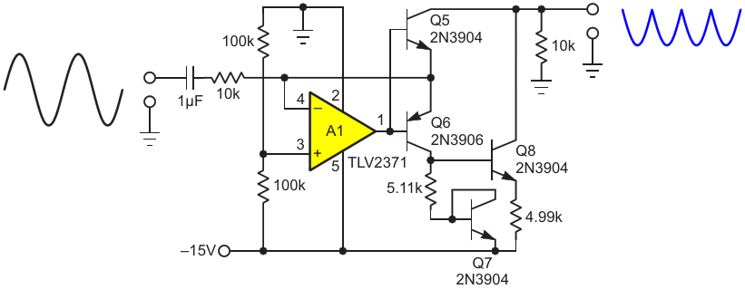

New full-wave precision rectifier has versatile current mode outputs
Figure 1. Full-wave precision rectifier incorporates complementar transistor pair and current mirror for current mode output
Figure 2. A bit of rearranging and a change of supply polarity produces a negative output
Figure 3. Current mode outputs can be easily summed up to produce a new function
