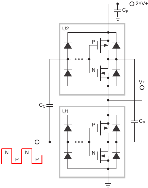

Simplified voltage doubler, showing …
Simplified voltage doubler, showing driver device (U1), commutation device (U2), and coupling (C

Figure 1. Simplified schema of typical basic CMOS gate I/O circuitry showing clamping diodes and complementary FET switch pair
Figure 2. Simplified voltage doubler, showing driver device (U1), commutation device (U2), and coupling (C
