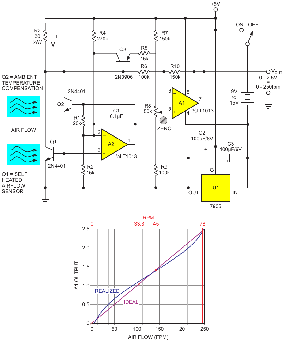

Linearized battery powered low …
Linearized battery powered low speed thermal anemometer

A groovy apparatus for calibrating miniature high sensitivity anemometers
Figure 1. GO/NOGO thermal low speed airflow sensor, ON/OFF airspeed threshold is set by R4
Figure 2. Linearized battery powered low speed thermal anemometer
Figure 3. "Groovy" anemometer calibrator built from salvaged phonograph
