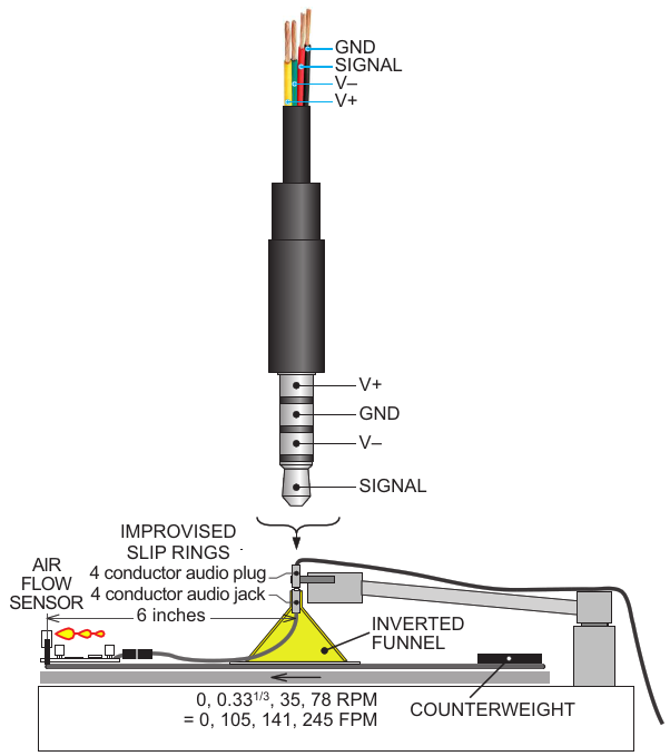

A groovy apparatus for calibrating miniature high sensitivity anemometers

Figure 3. "Groovy" anemometer calibrator built from salvaged phonograph
