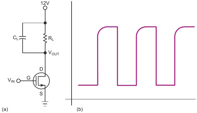

An N-channel FET driver (a) has output that exhibits an exponential rising edge on shutoff (b)

Figure 2. An N-channel FET driver (a) has output that exhibits an exponential rising edge on shutoff (b)
