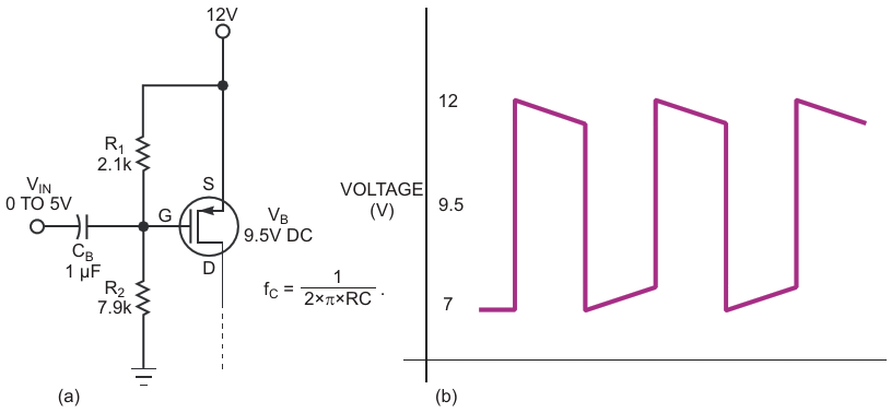

Adding resistive bias and capacitive coupling to an N-channel MOSFET (a) improves transition times but introduces waveform droop during on or off intervals (b)
