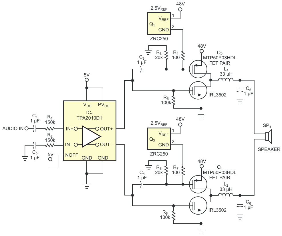

This Class D audio amplifier boosts its driver's output to 200 W rms for a 48 V power supply

Figure 1. The textbook complementary-CMOS pair (a) produces a clean output waveform with fast on/off transitions (b)
Figure 2. An N-channel FET driver (a) has output that exhibits an exponential rising edge on shutoff (b)
Figure 3. Adding resistive bias and capacitive coupling to an N-channel MOSFET (a) improves transition times but introduces waveform droop during on or off intervals (b)
Figure 4. Inserting a zener diode into the bias divider allows optimization of the coupling capacitor's value and the P-channel device's bias voltage for logic-level drive
Figure 5. This Class D audio amplifier boosts its driver's output to 200 W rms for a 48 V power supply
