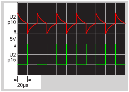

The 25 kHz multivibrator …
The 25 kHz multivibrator 10 V p-p waveshapes

Figure 2. The 25 kHz multivibrator 10 V p-p waveshapes
