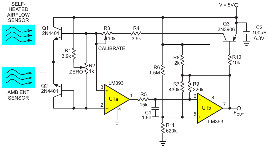

Constant-temperature anemometer with direct …
Constant-temperature anemometer with direct power-to-frequency conversion

Figure 1. Constant-temperature anemometer with direct power-to-frequency conversion
