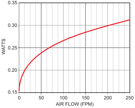

Q1 power draw versus air flow is typically a modest 200 to 350 mW

Figure 2. Q1 power draw versus air flow is typically a modest 200 to 350 mW
