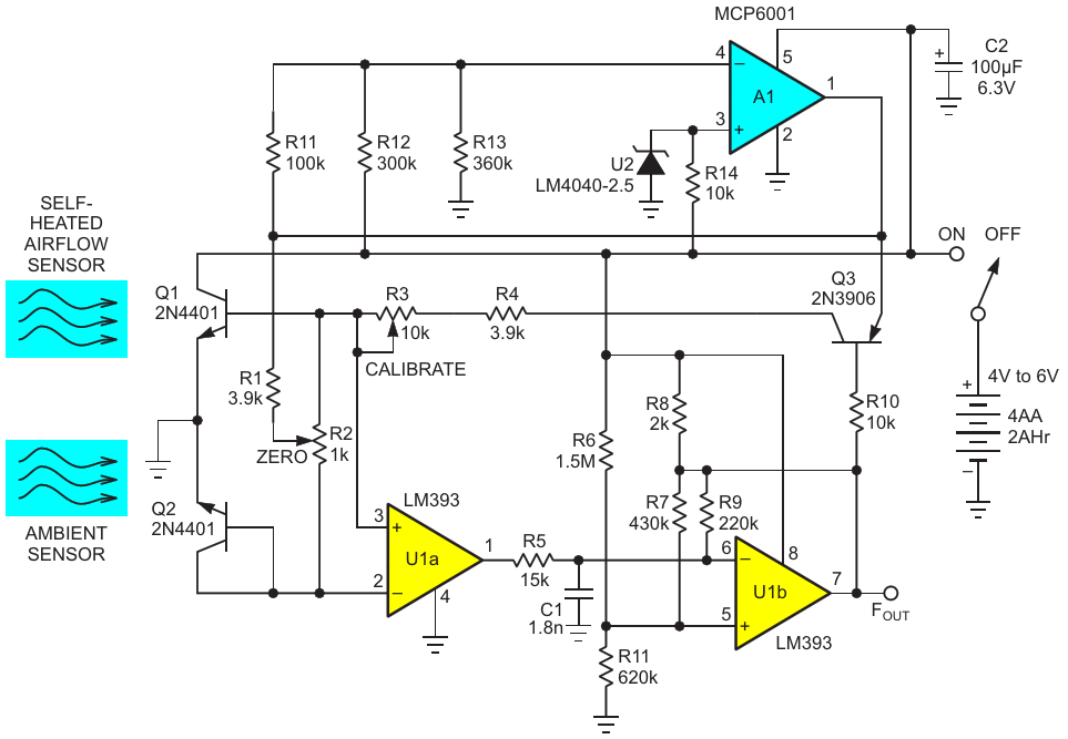

Figure 1's anemometer modified …
Figure 1's anemometer modified with U2, A1, and R11 - 14 to servo Q1 and Q2 bias currents to (mostly) null the effects of battery voltage droop

Portable thermal anemometer hot-transistor bias compensation nulls battery discharge droop

Figure 1. Constant-temperature anemometer with direct power-to-frequency conversion
Figure 2. Q1 power draw versus air flow is typically a modest 200 to 350 mW
Figure 3. Typical AA cell discharge droop curves with an undesirable ±20% roll-off of battery voltage during discharge, resulting in a degradation of anemometer calibration accuracy
Figure 4. Figure 1's anemometer modified with U2, A1, and R11 - 14 to servo Q1 and Q2 bias currents to (mostly) null the effects of battery voltage droop
Figure 5. Nulled (black) and uncompensated (red) Q1 heating versus battery voltage droop (5 ±1 volts)
